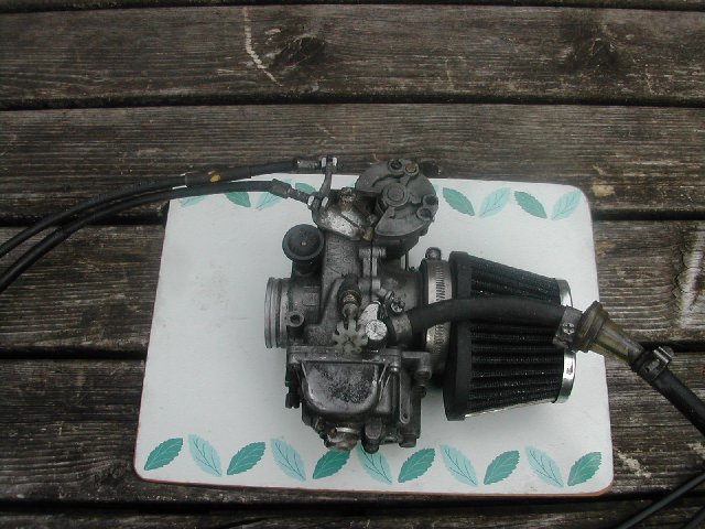

The alternative would be one of the Mikuni pumper 4 stroke flat slide carbs, either the TM33-something or the TM36-31 which I had on my old Electra-X. These have twin push-pull throttle cables, you wrap the ends round a wheel thingy where the ferrule sits in a slot, a bit like the twistgrip. Your switchgear cluster on the r/h handlebar is single cable, but being copied from Suzuki switchgear is easily be adaptable to twin cable. Let me see if I can find a picture or two.
My old TM36-31 (also currently resting between bikes). The TM33 is a different shape, but I remember a few years ago someone had fitted one successfully. Mounting for the 36-31 is best with a modified XT/SR500 Yamaha carb rubber flange, the only real problem with the 36 is that it's a tight fit under the rear gas tank mount. Given Ace's preference for not using larger bore carbs I suspect the TM33-? would suit your inlet tract better.
Twin cable throttle. The twin cables for the EFI models' throttle bodies look as though they'd fit, they appear to work on the same principle, the twist grip barrel from an EFI should also do the job. Mine plundered some used Suzuki parts!
Last I heard, international postal services are still operating.  ;)

Reply #72 on: April 04, 2020, 05:27:16 pm
Well, fitting throttle springs around cable ends and slides can be a fiddle for young or old with ANY carb. I notice Dell'Orto have three different strengths of throttle spring.
A.
      I believe I will leave well enough alone. Bike starts good, runs Grrrate, no problems in any gear or at any RPM, smooth as pigsh*t. I doubt I'll even be able to be on the road. I'll get hauled in on a trumped-up charge of "Solitary Biking".
       I'm gonna stick with the bitch I know rather than take on another bitch I Don't know.
        Thanks for the offer and all the words.
