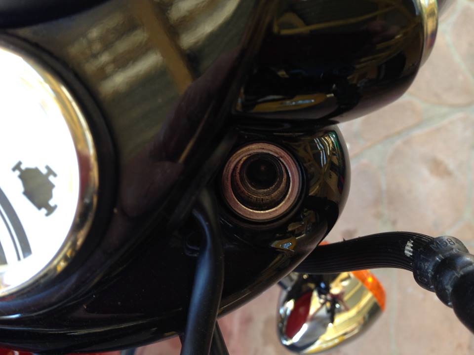

I decided I might have a go at this fork oil change. I undid the top cap and found it was fully threaded into the depths of the housing
after that I shone the torch inside the housing and much to my surprise - no hex head or anything at all I could see to attach the 12mm hex shaft too
after that I decided not to go ahead and wait it out for answers. is it possible that threaded fork shaft bolt replaces the hex style which was originally unscrewed in earlier models to release the shaft?

Your forks are the same as mine. That top bolt holds the fork leg into the headlight casquette. If you have removed the front wheel and mudguard when you slacken the bottom fork clamp bolt the fork leg will just pull down and out.

thanks...after seeing that I didn't go any further and stopped immediately LOL

The fork legs DO NOT screw into the casquette on my 2016 C5 with the straight forks legs. They are plain and unthreaded. The top cap is normal right hand thread. Anticlockwise to undo.
