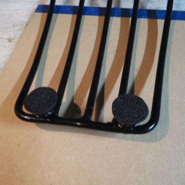

   Start by applying the hook side (with loop side attached) to the four cups on the grill. Press the Velcro down into the cup for maximum adhesion.

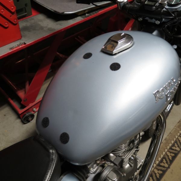

   Then simply placed the grill in an optimal position on the tank, and firmly press again.
   Leave in place overnight.
   The grill can now be easily removed by simply separating the velcro at each point of it's attachment.
   Hook side on the cups.
   Loop side on the tank, with grill removed.

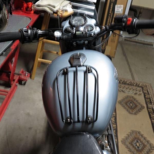

   Grill on the tank.

   The Velcro is not the strongest out there, so I wouldn't expect it to hold if my tank bag was attached only to it.   I'm using the Velcro to hold the grill in place mostly for the sporty look. At a steady 65mph it holsd by itself just fine, but when I take it to Aurora this Spring/Summer I'll be putting my tank bag on top of the grill then using the bag straps around the tank to secure it.

   I found that though the suction cups work well in cooler temps, they eventually would loosen as the temps rose requiring re-setting them to maintain suction.   While not a major concern, the cups eventually marred the paint finish requiring some elbow grease to buff them out.    My original solution (velcro) was workable, but the adhesive in the cup and on the tank softened enough in the sun to allow the grid to occasionally drop into my lap while riding. Seriously annoying!
    My latest fix:
1) Remove the Velcro pad from the suction cup,
2) Remove all traces of the Velcro adhesive from both the cup and the Velcro pad,
3) Apply silicone sealant to the cup, press the recently cleaned and dried Velcro into the cup, and allow to cure.
Have not had a problem since.
