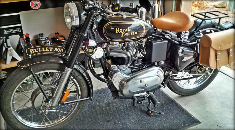

So commuting in Tucson (recently ranked 15th on worst cities to drive in) on a motorcycle, even with my conservative riding, I have to use the horn from time to time.  The stock horn wasn't cutting it.  It worked as it should, but was a very meager 'meep'.  :P

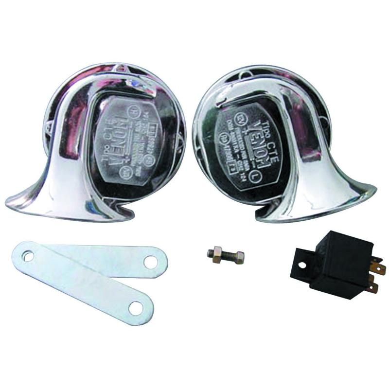

I picked up a set of these after seeing some videos on Youtube about them.  I found them on sale for $7.99 at Harbor Freight.

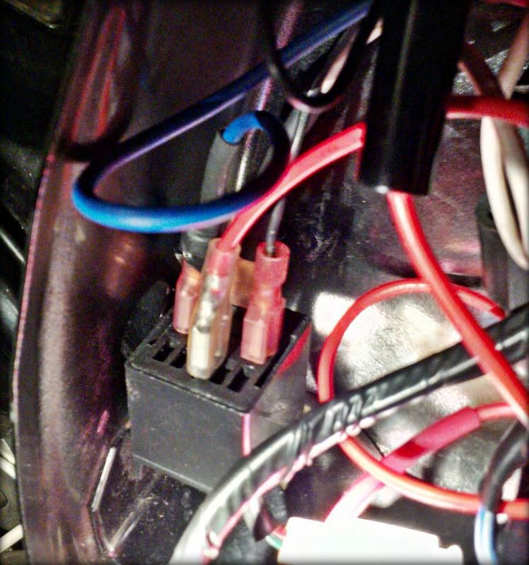

The wiring was pretty straight forward, the relay mounted right to a mounting bolt in the left side toolbox.  I used a 10A in-line fuse for the direct power.

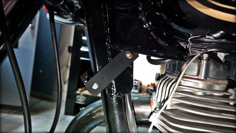

Painted the brackets black to make them less noticeable.  Not sure I'm crazy about the mounting location I chose.  I wanted to go either high or low, I didn't want to obstruct air flow over the iron barrel.

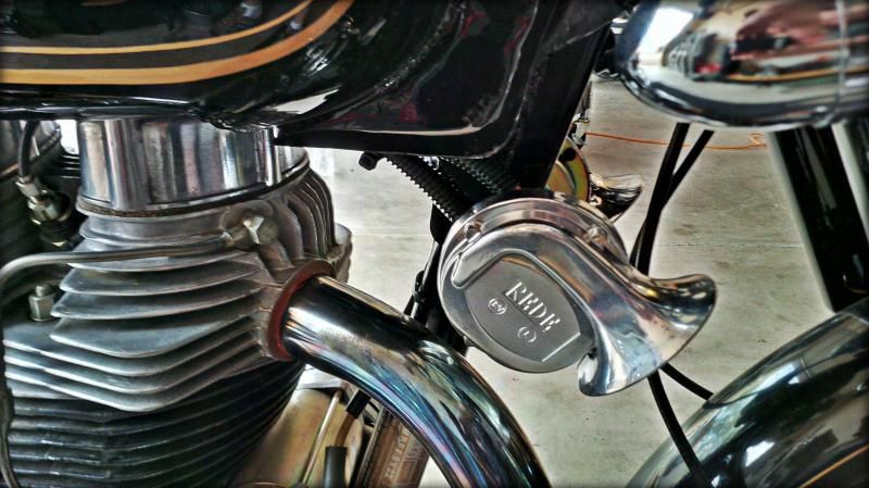

And the finished product...
Not too bad from a distance...

The sound comparison starts about 45 seconds in.  It is a huge difference, I mean huge!  In fact, I'm holding the camera when my son hits the new horn for the recording and it startled me even though I was expecting it.  Cagers will be looking for a Cadillac when they hear these horns...  8)

I used the stock horn wires to go into the relay.  Once I unwound the harness, the stock wires reached and allowed me to hook up the relay in the left side triangle tool box next to the main fuse.  Then I ran the wires out of the relay back up front and into the horns.  I used a bullet splitter and bullet connectors under the tank.
